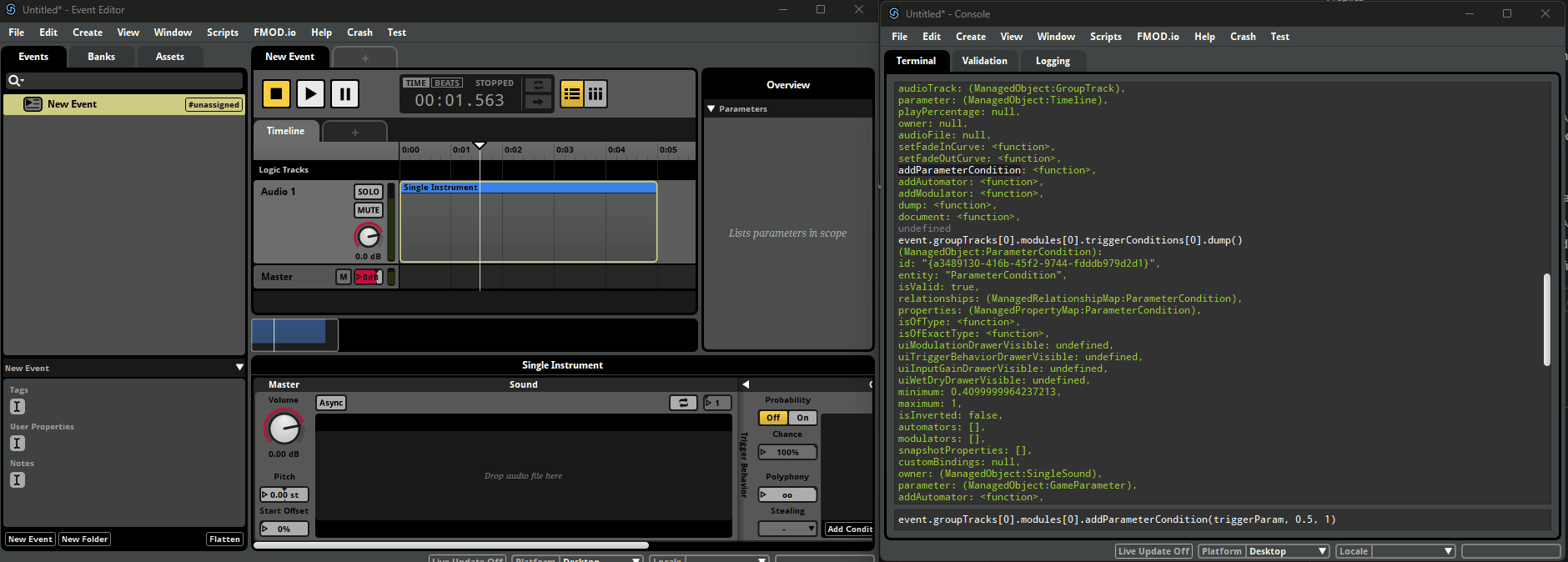

Thanks for sharing the code. I am not sure what mod is but the issue may be that the groupTracks.modules is an array so you have to specify which one you are trying to add the ParameterCondition to:
var event = studio.window.browserCurrent() // Make sure an event is currently selected with a single instrument in the first audio track
event.groupTracks[0].modules[0].addParameterCondition(triggerParam, 0.5, 1)
AddCondition

Thanks for the info,
I made a script that will apply a parameter trigger to all single instruments:
ApplyParamtrigger.txt (3.9 KB)
Hi Connor,
Thanks a lot for your answer and for the script! I’ve just adjusted it to fit my project, and it works fine.
Thanks again!
