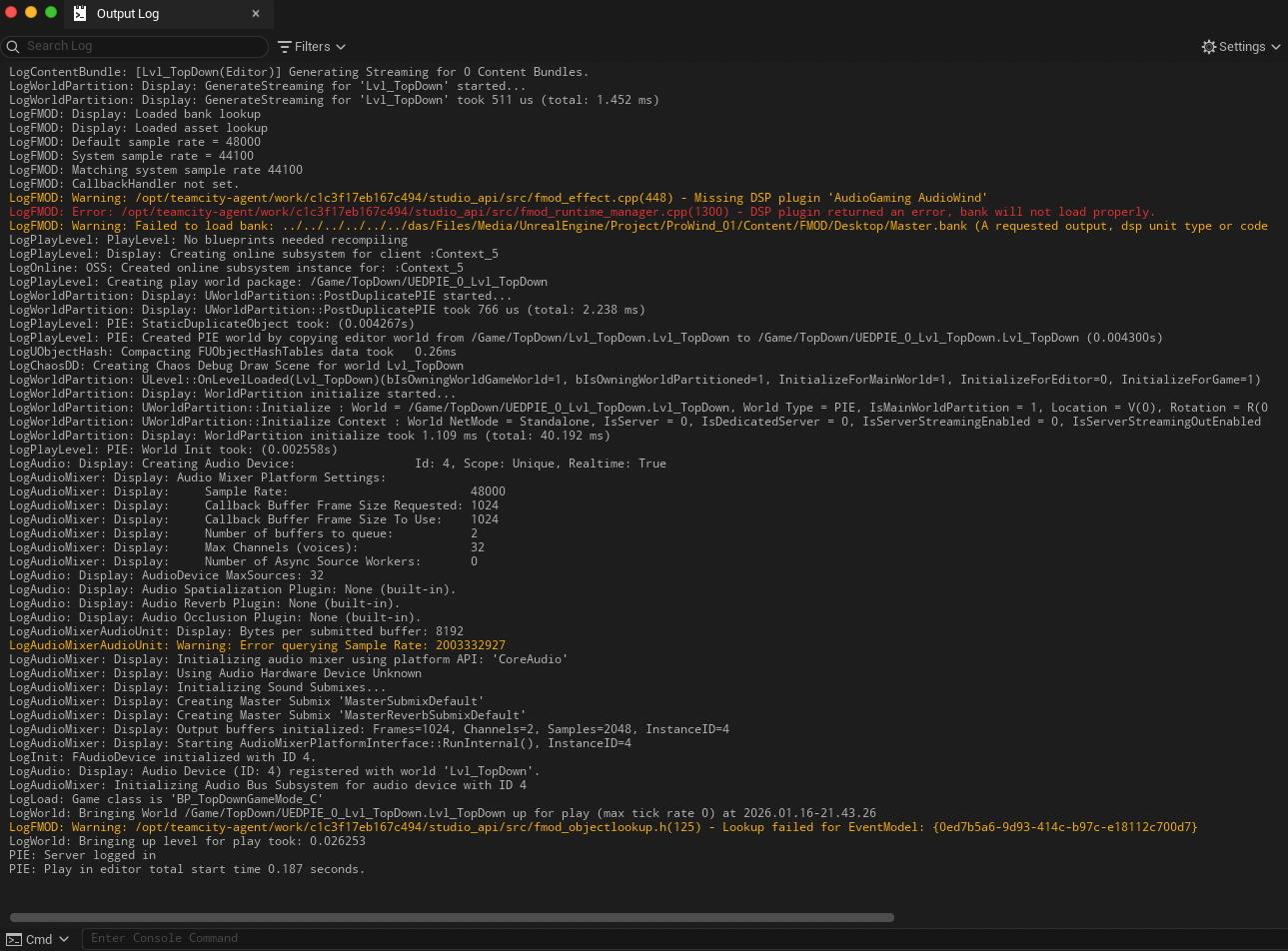

I also ran a test to present you with the Output Log results. I have attached a graphic of UE Output Log. It was a very basic test. I dragged/dropped a 2D FMOD Event into the level editor of one of UE basic starter templates. At first, the 2D Event contained one looping audio file. Everything worked as expected. Secondly, I added Le Sound’s AudioWind to the 2D Event and rebuilt the FMOD Master bank. UE acknowledged the new build. In UE, however, the 2D Event no longer worked: “silence”. The Output Log confirms the plug-in error.
Thanks for running that test and sharing the UE Output Log screenshot, that’s very helpful.
From the screenshot it looks like FMOD is reporting a missing DSP plug-in (e.g. AudioWind). In that situation, the bank can fail to load correctly, and any events that reference the missing DSP may play as silence.
Have you tried to contact sales@fmod.com? They can advise on whether a plugin is available commercially and, if so, how it is purchased.
Sorry for the confusion here. FMOD Studio ships with a small number of trial plug-ins to allow evaluation in the tool. However, those do not imply guaranteed runtime support in any specific engine/platform without obtaining the appropriate licensed plug-in binaries from the vendor.
