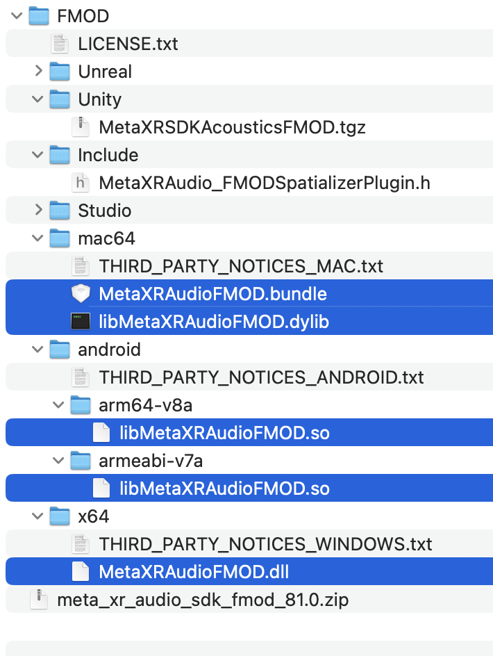

These are the files I am copying:

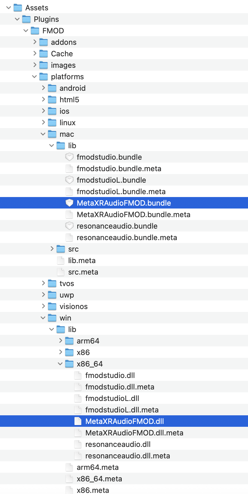

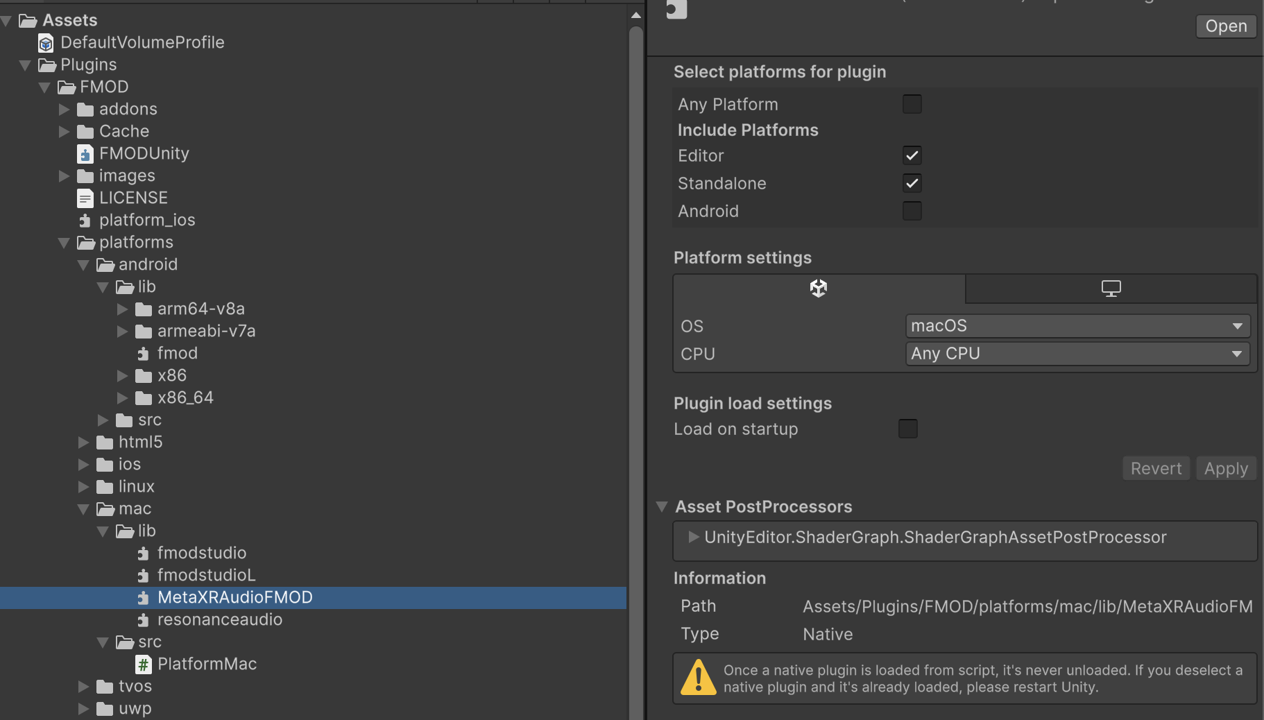

And here is where I have copied the files in my Unity project:
I’m also configuring the Unity settings for the files like this:

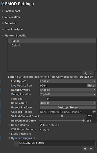

And finally I’ve added it to the list of dynamic plugins in the FMOD settings:

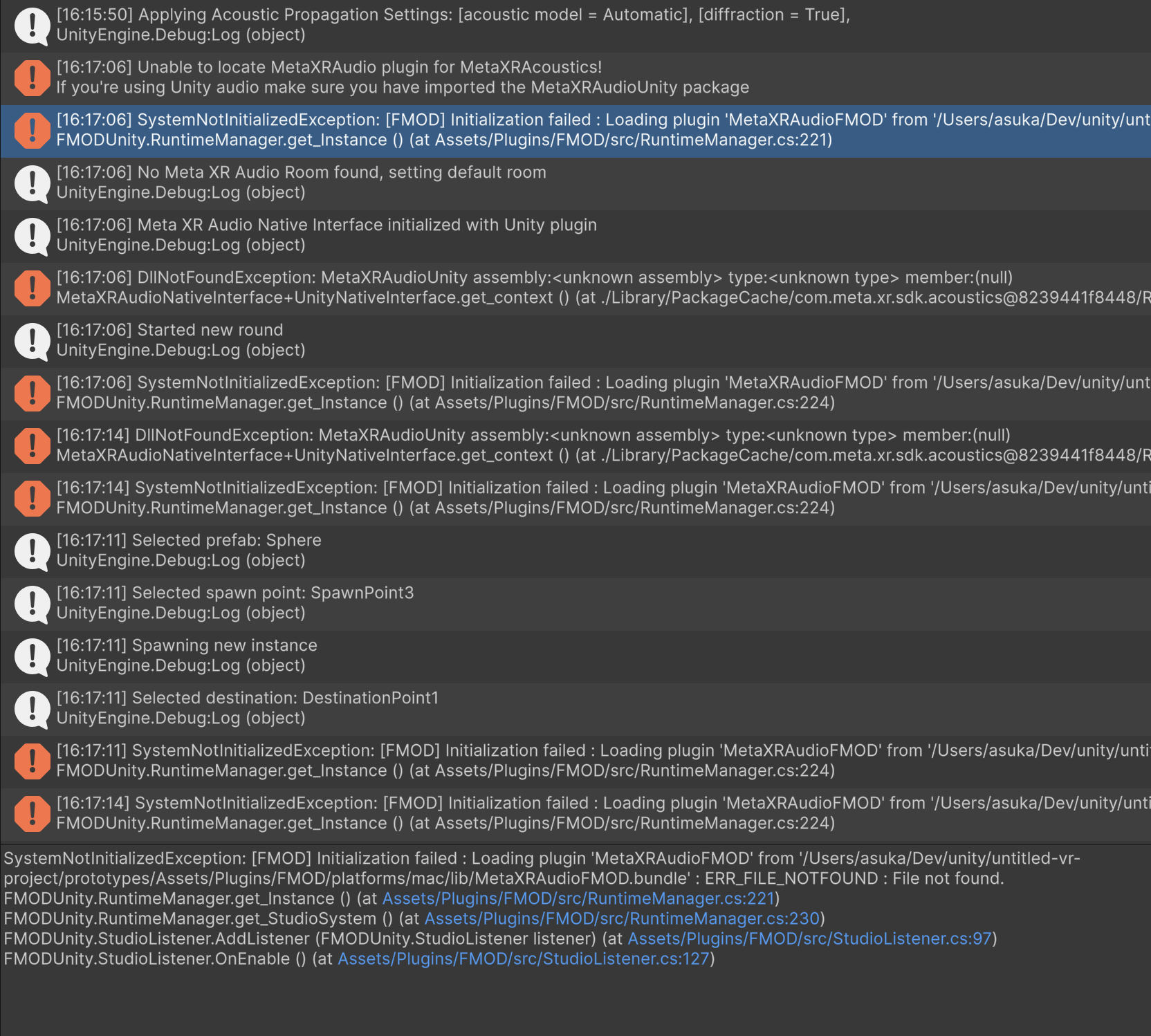

When I try to run by pressing play in the editor, it complains that the file is not found:
The file is definitely there, in that exact location:
The first thing that’s unclear, for mac should I be copying the MetaXRAudioFMOD.bundle file or the MetaXRAudioFMOD.dylibfile? Based on the other files that ship with the FMOD plugin, it seems the .bundle file should be the one.

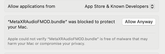

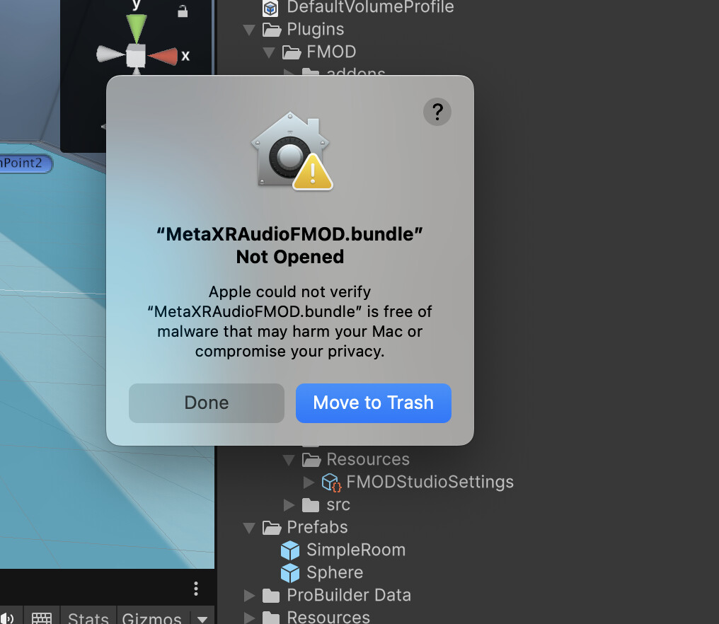

I thought it might be a permissions issue with the MacOS security:
but I went into settings and allowed the file to load anyway:
and I also did xattr -dr com.apple.quarantine MetaXRAudioFMOD.bundle on the file for good measure. It is not complaining about that anymore, so I don’t think this is the issue.
