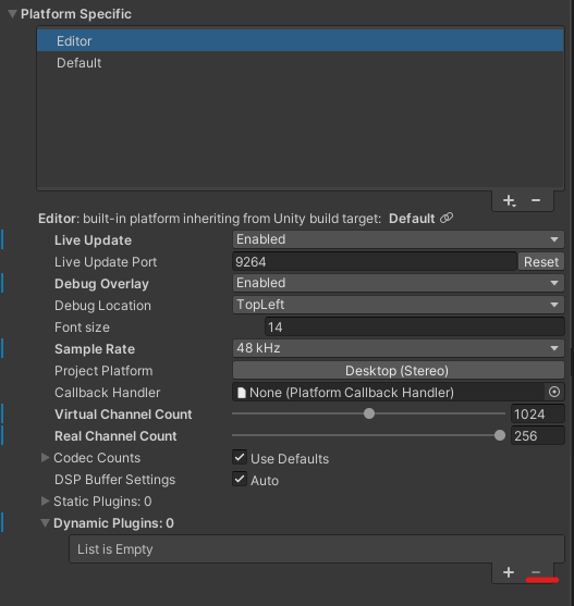

To ensure that your project functions correctly on the HTML5 platform without audio issues, you will need to remove all effects associated with the Resonance Audio plugin from your FMOD Studio project. Additionally, please ensure to remove resonance from the list of dynamic plugins in your FMOD settings.

To assist you further, there is a tool in FMOD Studio that can help you efficiently remove these effects. You could use the Filter by Effect feature to locate all events associated with the Resonance Audio Plugin.
