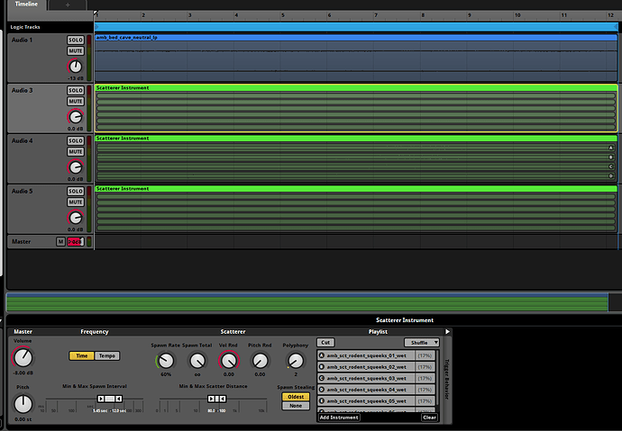

So I have an 2D Timeline ambience event with 1 stereo loop and 3 scatterer instruments in 3 seperate tracks. When i’m loading a scene in Unreal and play, I only hear the loop and none of the scatterer instruments.
I’m aware that this is kind of an issue that other posted before but I never really got the answer I wanted. I am aware of the workaround of putting the min&max scatter distance to 0 and like automate the panning of each track but the thing is, it was working before. I’m not sure why but it stopped working and I just want to be sure what is possible.
If I put the min and max distance to zero yes it works but as soon I add some distance , even if its 3 and 10 or 80 and 100, its doesnt work.
I have no spatializer anywhere. Is there someone else who got this exact issue ?
Like I said, the setup in my screenshot was working at some point.

The listener is on the player (its a third person game) The event is called inside of a audio volume via a custom blueprint script. So when the player is inside, the ambience play. The goal is when you go to different room or being outside and you go inside a building or something, the ambience changes and the scatterer instrument helps to create randomisations instead of placing “emitters” manually.
Thats the main goal here. I tried dragging the event in the scene just for testing and I could hear the scatterer instruments normaly. In my script I’m using a Fmod event instance type but when i’m dragging the event in the scene it becomes a Fmod Ambient Sound. Could this be the source of the problem here ?
