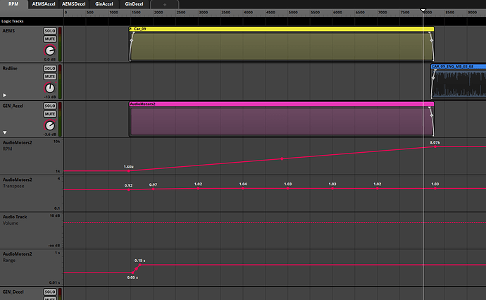

Here is the Event in FMOD for this paticular Car. The nested event contains just looped samples that blend according to the RPM with root pitch.

Ok I was able to narrow it down. You are right, it is not the autopitch of FMOD, it is the Plugin Audiomotors.
Into the plugin is a RPM value fed so the plugin can choose the correct grain (its a granular synth) to play back at runtime. additionally the plugins “transpose” parameters automated and used to align the synth with the looped samples in FMOD. When muting the plugin the problem does not exist (or at least it is not too apparent), but when only using the plugin without the looped samples the problem is really obvious.
