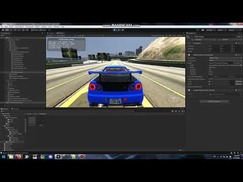

Hi Bro
I Did this script and its run and working but the sound of car look like annnnnnnnnnnnnn just like this
not playing the full track and iam use the example of carengine fmod
this video i recorded explain everything
So the issue may be with the effectiveRPM. Maybe try logging it and make sure it is the right value. It may need some changes to its math.
