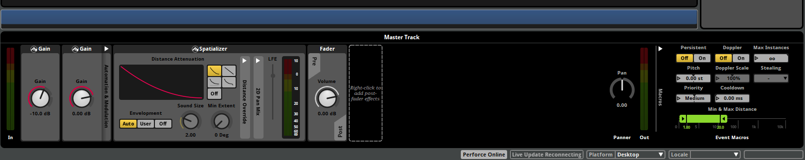

I can set this behaviour from within fmod, by placing the sound on the Distance parameter and set it to not play when distance is above 10 meters.

Also, Would it be possible to get a screenshot of how you set the waterfall event in FMOD?

Even though I have this set:
The weird thing is, that if I set the value high (0.1 or the like), I can hear that many sounds are not playing. So it’s doing something. But whatever it is doing, is not reflected in the profiler at least.
