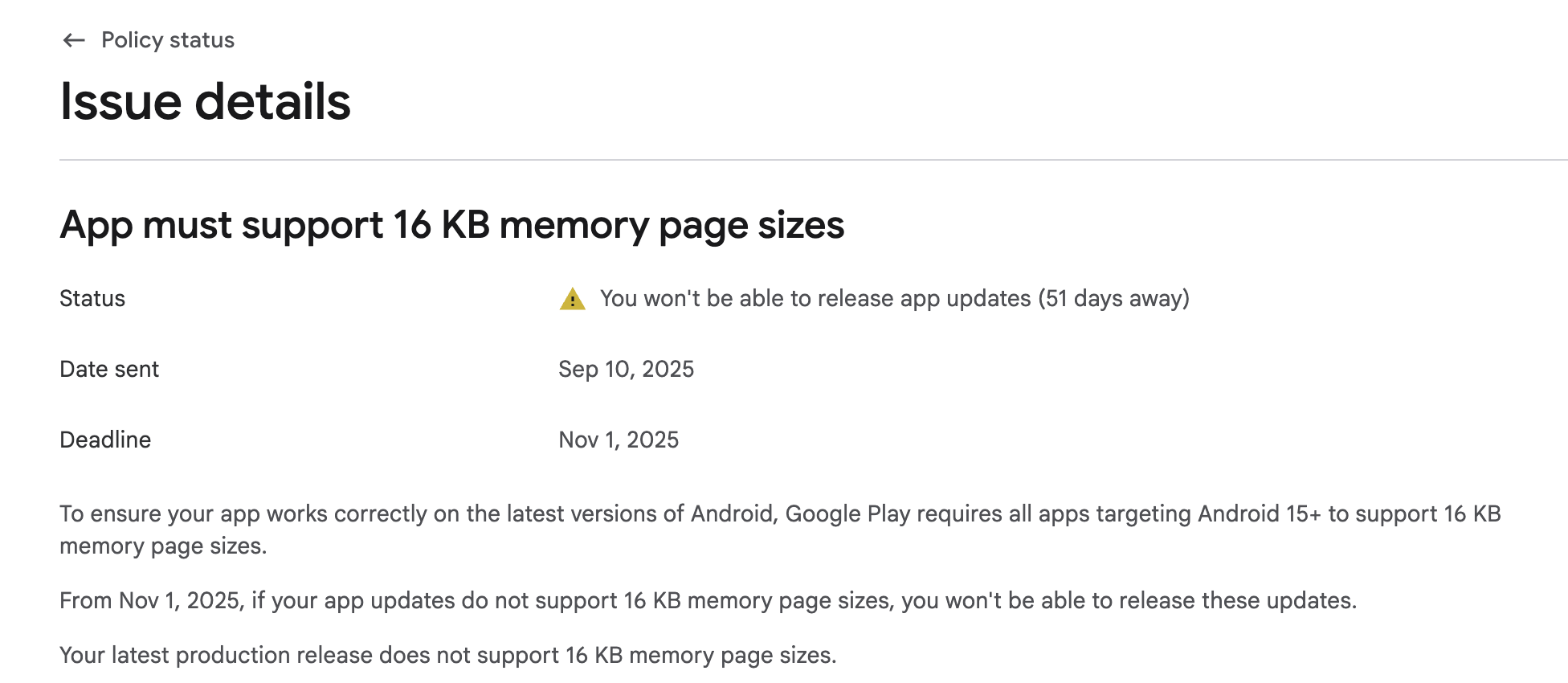

@FMOD_Aaron Google has issued warning that they wont accept app releases if we don’t support 16KB Page size. So the issue is not that game wont work but we wont be able to publish updates. If you guys can release a patch with just 16KB Page size compiled binaries, it should work. Files affected are:
Plugins/FMOD/platforms/android/lib/arm64-v8a/libfmod.so
Plugins/FMOD/platforms/android/lib/arm64-v8a/libfmodstudio.so
Plugins/FMOD/platforms/android/lib/arm64-v8a/libresonanceaudio.so
The libs themselves are already correctly aligned. The warning comes from the .meta files being out of date, which is a known Unity issue UUM-111393.
As a temporary workaround, you can go to:
…\Assets\Plugins\FMOD\platforms\android\lib\arm64-v8a, open each related .so.meta file in a text editor, and add the following flag under platformData > Android > settings:
Is16KbAligned: true
Could you please give that a try and let me know if the warning still shows up.
