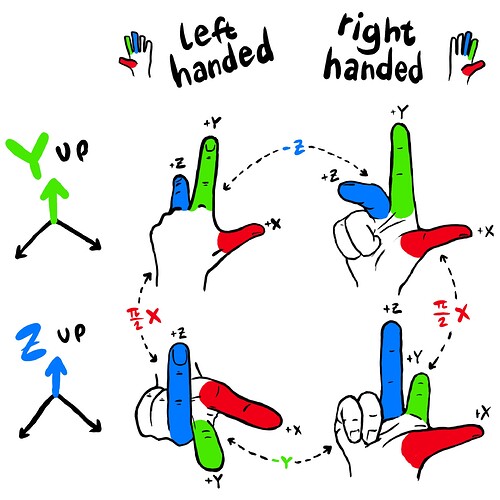

I’m trying to make gunshot sounds have a spatial effect based on distance and floor they are on and I’m not sure if I’m setting up the vectors correctly:
I think what I want is a left handed coordinate system where Z is up and y is pointing down(the bottom left of the figure)? So that way I can just pass in my tile coordinates x: 5, y: 10, z: 2 (entity to the right going downwards but on 2nd floor)
