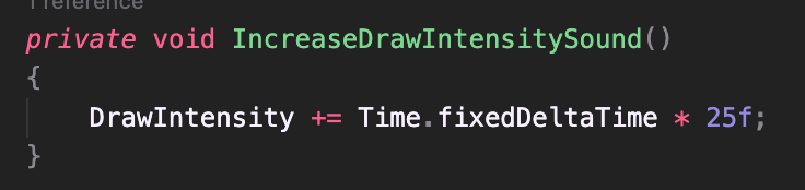

- And from the dev: The parameter’s value is not being driven by a moving objects’ velocity vector. The Velocity parameter value is controlled by a float variable which increases when the player draws x distance of stroke (input-driven drag callback), and decreases over time to a minimum of 0 (FixedUpdate).
And for a bit more context, the event provides sound when drawing in the sand, and so velocity is tracking that speed.
