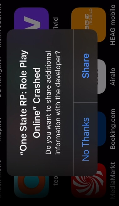

Have you had reports specifically from users or only from crash software which may be misinterpreting what is happening with FMOD
There is an opinion that this can happen when the application is unloaded from memory by swiping, and a system error message appears at the moment
However, it was not possible to reproduce it within the framework of the bug investigation
