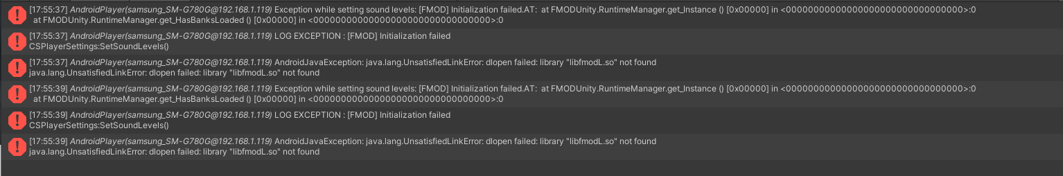

I see, probably not related to this issue then. Can you please enable API Error Logging in the FMOD Unity settings and send through a log of when you scroll the top bar or send an in-game message?
And these errors are happening after swiping down the top bar or using the keyboard?
I think I will need a reproduction to investigate this properly, would it be possible for you to please upload either a stripped down Unity project or a debug build of your APK to your FMOD Profile for me to test?

I have uploaded two separate debug log files for you. One for the pull down of navigation bar sound error and the other for the random audio interrupt.
Thank you for sending that through, that’s providing a lot more information now. I am still missing some of the information I need because I forgot to ask you to set the Logging Level to “Log”- which will provide information on mixerSuspend, mixerResume and should tell me when the audio is starting and stopping.
So, sorry to ask again, but this time can you please set your Logging Level to “Log” in the FMOD Unity Settings and send through another full log?
