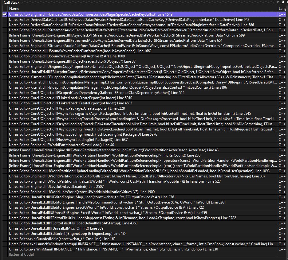

I tried running debug via VS2022, here’s the callstack at the breakpoint. I don’t know if this might help…
More curiously is the Autos during this breakpoint (I’m not super knowledgeable about VS debugging, but I do recognize this “Sane Audio” thing, as it’s a variable name in that actor that I made. This is possibly an UNSET fmod event variable? A placeholder if you will.)
Wow. Immediately after noticing that in the Autos, I removed the actor UASSET file with that empty soundwave variable and then tried booting up my project again. Success! I added the actor back and removed the offending variable. I don’t think it was an FMOD event after-all.
