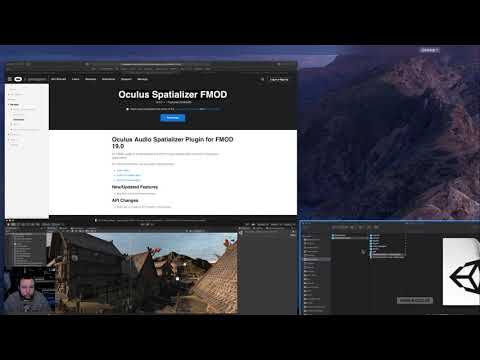

As I believe I installed the oculus plugin correctly for fmod and unity, why is it that when I apply the oculus spatalizer to an object in game, I can no longer see the attenuation spheres?
I’ve tried to override attenuation as shown in the video below at about 14 minutes in to control the attenuation inside unity instead of the fmod UI, but my option for that is greyed out entirely and I just simply can’t turn that option on, though I can if I otherwise use the fmod spatalizer. Switching it back to the oculus one will again just disable the view of the sphere.
