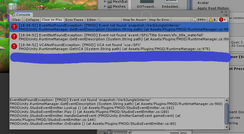

The error happens when we untick Load all Event Data at Initialization. And in the script, we load all the required banks except for the language banks.
But this error of EventNotFoundException and VCANotFoundException happens when we load the banks by scripts.
In the main camera, we already put in the studio listener index based on the forum I checked regarding the VCA error. Any kind of help we can get from is really appreciated. Thank you.

Are you calling your LoadBank function before the StudioEventEmitters are being triggered?
It looks like they are using OnEnable as the trigger to start the events and GetVCA is being called from MusicManager.Awake.
